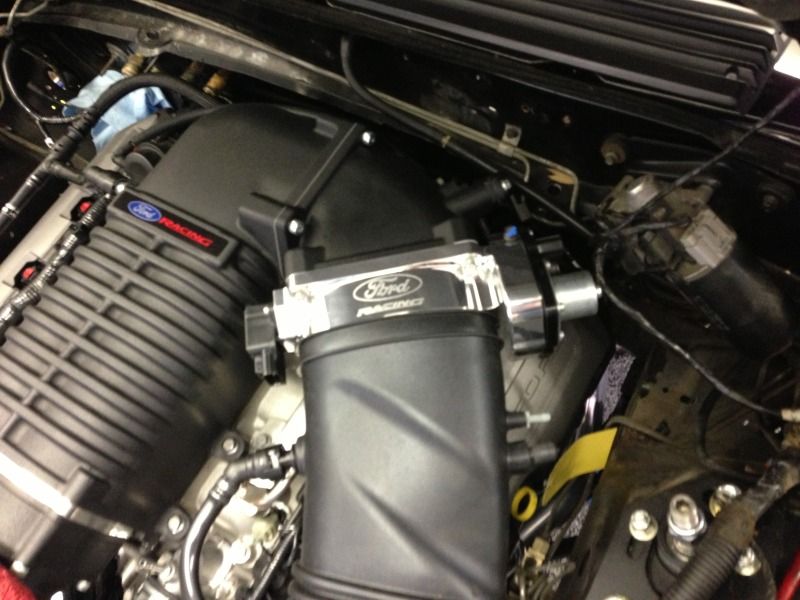

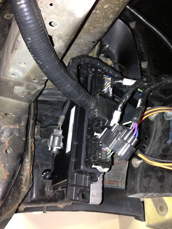

Well a little more progress. I have been trying to find where to mount the computer and where to run the wires. I have finally decided to put the computer in the passenger side fender well. It will not be visible from under the hood but will be tucked up inside the fender. It will not interfere with the fender liner or suspension components. i have it roughly sitting in the right place. I have to build a mount that will weld to the frame. I haven't started to TIG weld yet so I am going to use it to learn with. Unfortunately my MIG skills aren't as good as I wished either but I am getting better with practice.
Here is the close proximity to where the computer will mount

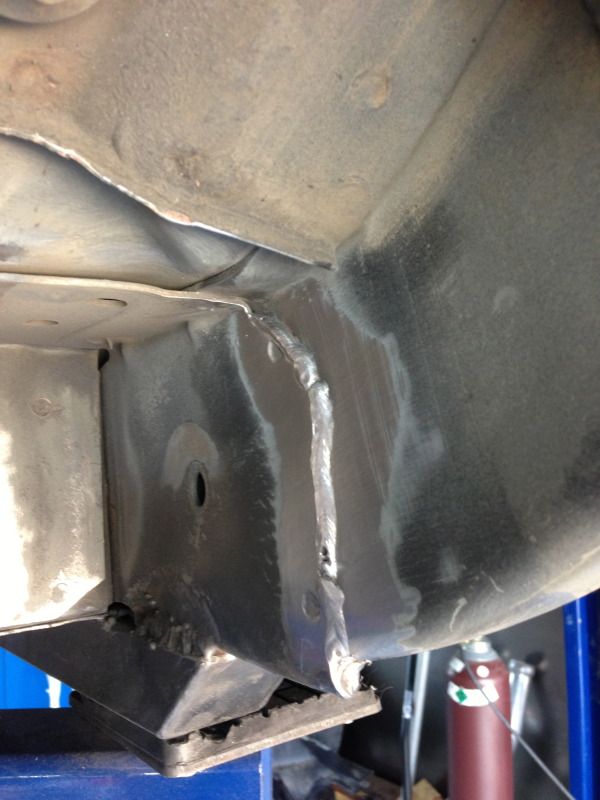

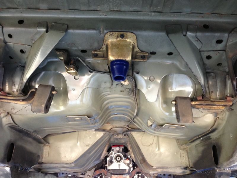

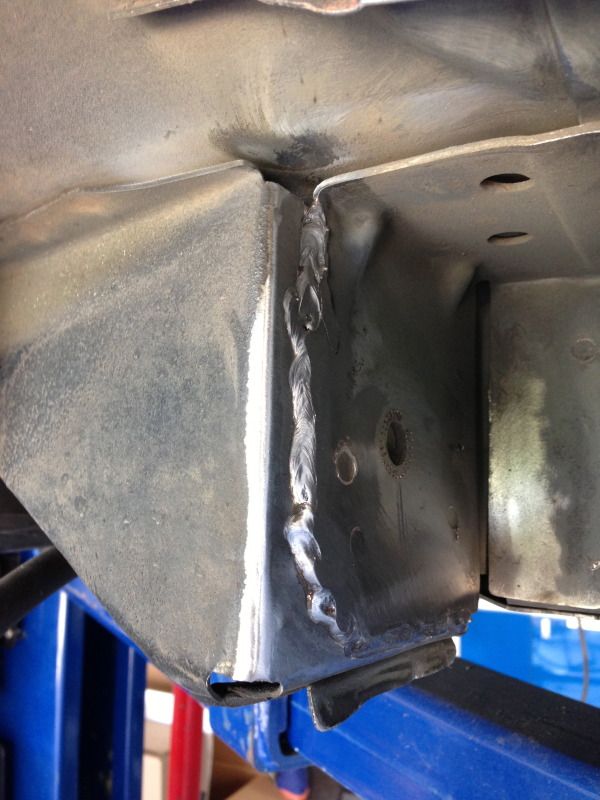

I did clean up the rear floor pan underneath the car. I also welded the lower torque boxes in. I know my welds aren't the best but they are going to hold well and aren't hideous.

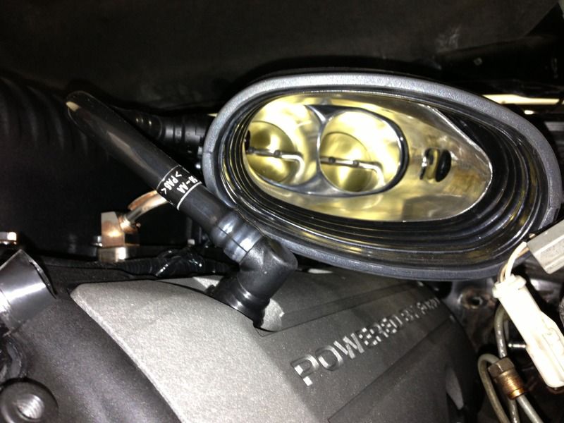

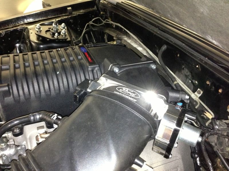

I got a new part in on Friday so I thought I would put it on. Still waiting on the new JLT Cold Air Kit

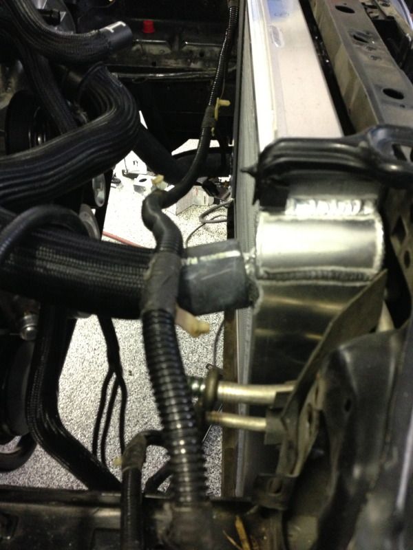

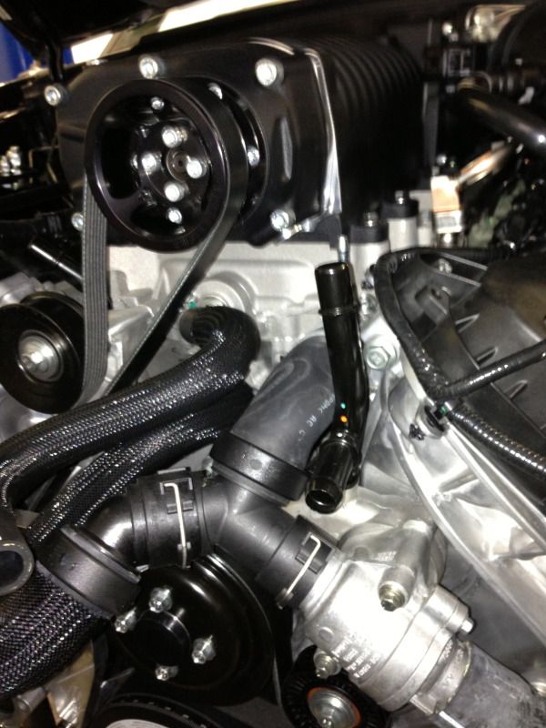

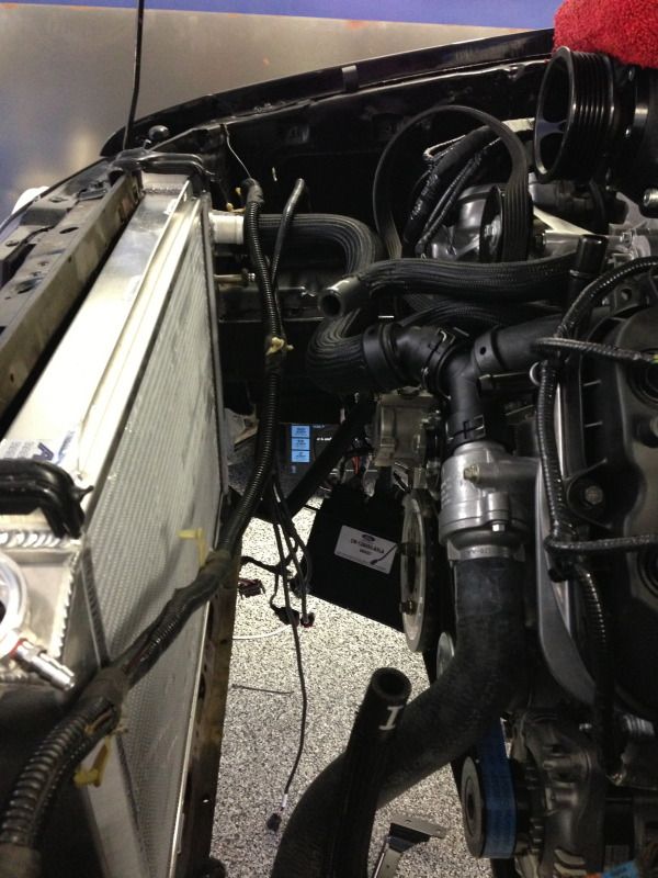

I know that some of the next photos may not make sense. They are of the routing of the heat exchanger hoses.

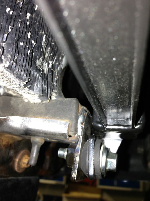

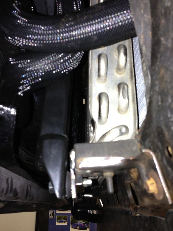

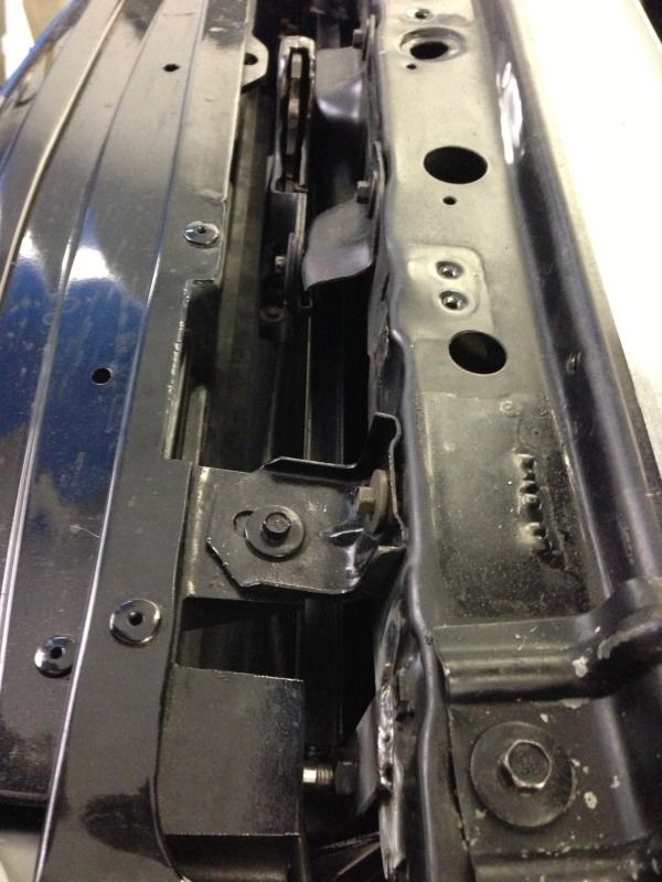

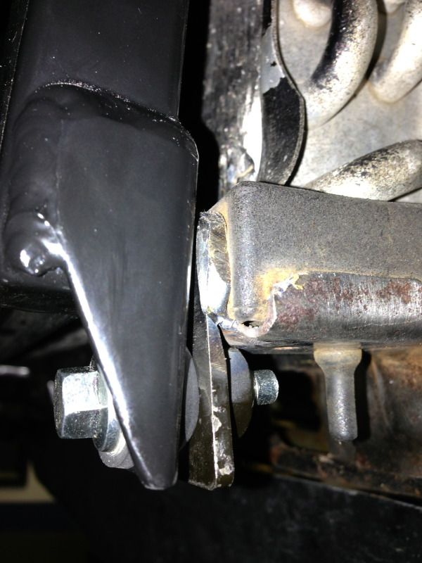

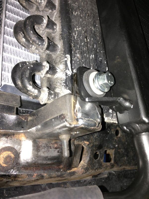

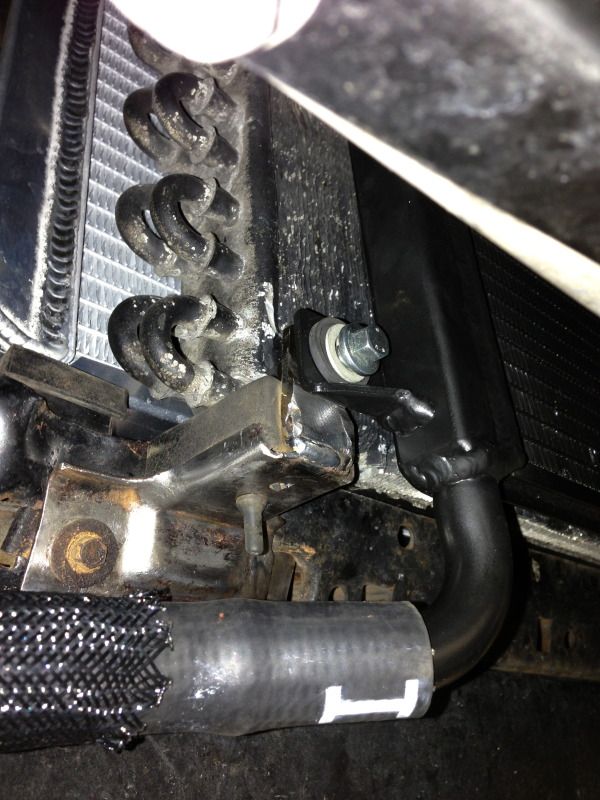

I then moved on to actually mounting the heat exchanger. I utilized all of the bracket for the 2011-2013 kit but I had to modify them all. I welded the upper tabs to the upper radiator mount. The lower tabs I welded to the A/C Condensor lower mounts. This worked really well. I had to sand tons of rust of these lower mounts. I will probably have them bead blasted then powder coated in the final phase of the install.

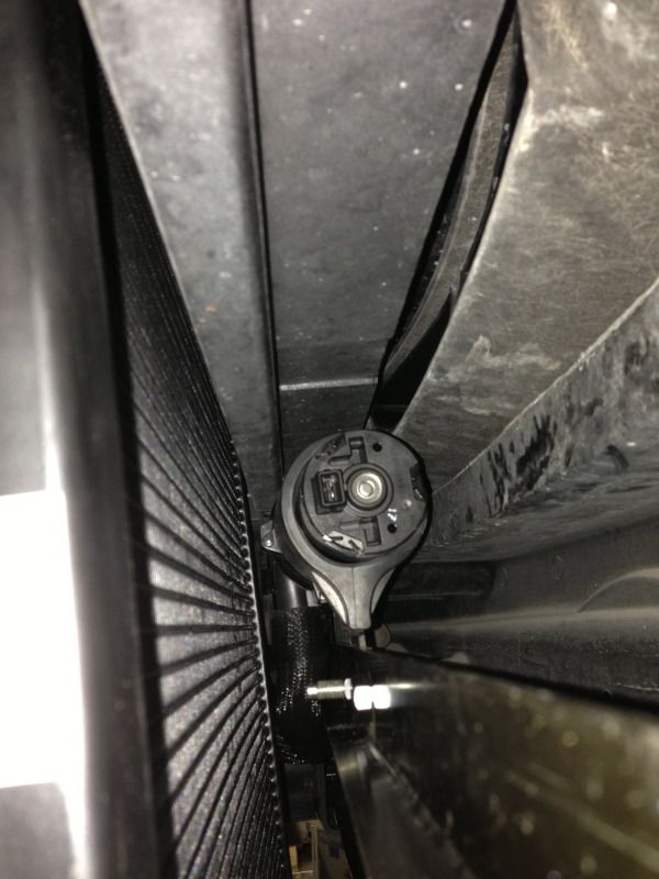

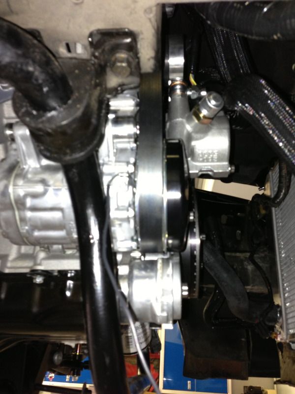

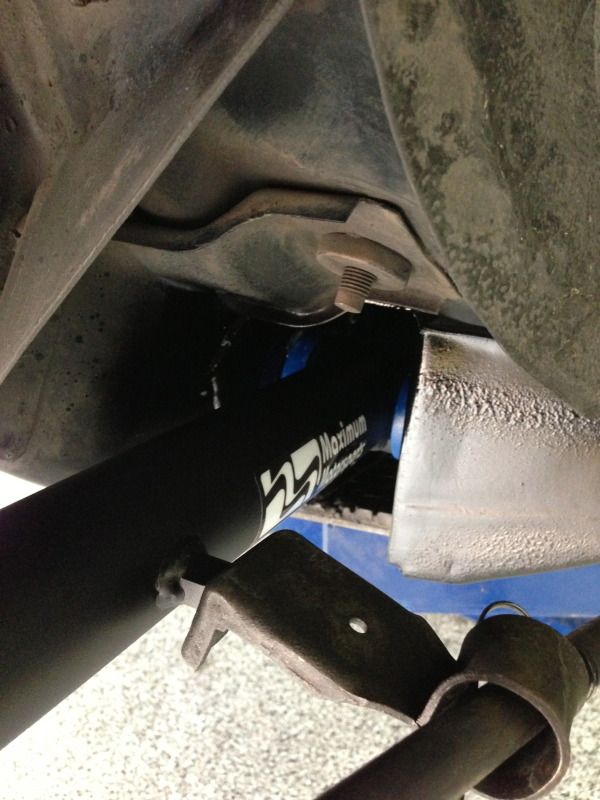

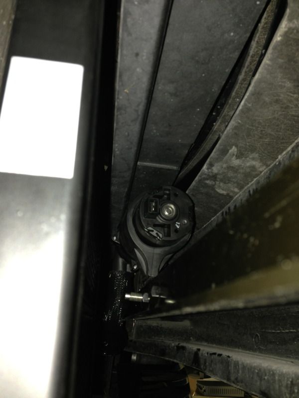

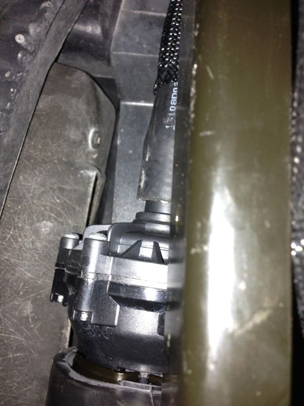

Here is the final mounting of the heat exchanger and the pump. I utilized the 2011-2013 mount for the pump as well. I had to modify it quite a bit. I will probably make a new one as I don't like it too much.
